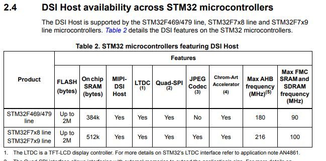

Hello @ilyus and welcome to the STM32 Community =)
I recommend to take a look at these resources available on the ST website:
Hope this helps you.
Please mark my answer as best by clicking on the "Select as Best" button if it helped :smiling_face_with_smiling_eyes:.
Imen
2021-04-23 5:16 AM
This is pretty useless information, I've read all of this several times. These are specs of MCU, not specs of DISPLAY. The fact that MCU can output 9000 different frequencies doesn't mean this specific display supports them. So sorry, your answer is not correct :(
