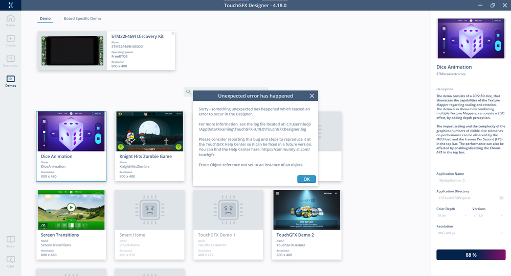

2021-11-14 9:21 PM
An exception occurred when I opened the demo.

2021-11-14 9:41 PM
I solved this problem myself.
The reason is that mysql is installed on my computer, and everything is normal after uninstalling.
