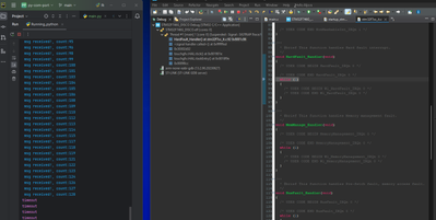

I have increased the stack size to 5120 bytes and the error still occurs. This is a huge stack size for an embedded application. However, the error is very sporadic. Sometimes it somehow misses the command from the Python script and waits there. When I press the USER button again , it starts from the begging again. I can do this couple of times before a hard fault is happening. Other times it jumps directly in the hard fault after the timeout as shown in the picture above.

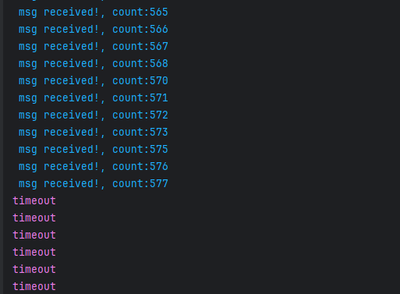

Here is the image of the python script output:
Here is also an output, where the discovery jumped after the first timeout:

"You only have a log for receiving messages.
I think the timeout can happen if the Python script doesn4t receive anything for a long time or if the Python script is trying to send something and there is no viable receiver."
I think the first explanation is the reason for the timeout. Because the python script is not receiving anything, therefore the timeout is called. The reason why this is happening is because the STM32F746 is going into hard fault and it is irresponsible. My question is why is this happening? What am I doing wrong in the code?
