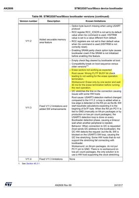

Can you share your bootloader version ? I would recommend to check these known erratas described in AN2606 :
Let us know

2026-01-04 10:18 PM
This is I got from cube programmer
