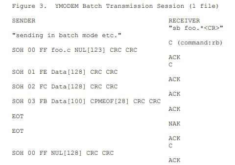

What exactly does ST mean? What is the exact expected sequence?
Do you mean like described in
http://www.blunk-electronic.de/train-z/pdf/xymodem.pdf
on page 16, Figure 3
Is this the expected sequence?
Thanks and BR
EW

Yes this is more or less the sequence, Are you having any problem with ymodem? Maybe, using teraterm?
-- pa

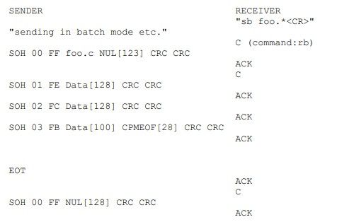

2020-01-06 7:04 AM
It seems to be in this way:
