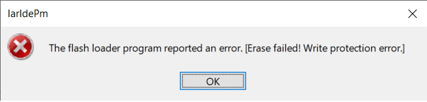

Hi @Domenico ,
I have flashed the SBSFU application with by mistake write protection enabled for flash address 0x08000000. I am unable to erase using jlink commander.exe as well as by IAR->project->Download->erase. Please suggest me how to erase the flash of STM32H743II.
2023-03-23 3:35 AM
@Domenico This is the error i am getting from the IAR IDE.
