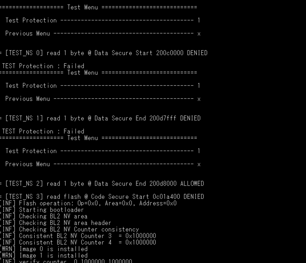

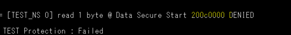

The NS app launch successfully but the Test protection already included in the NS App is not working as wanted.

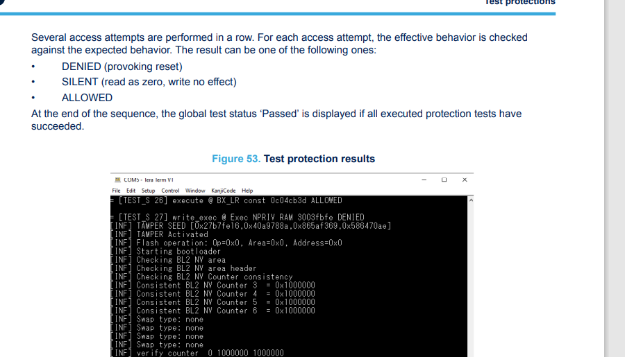

The two firsts tests that it is doing are DENIED, which seems normal, and which normally should provoke a reset as written in page 59. This behaviour is well executed for the next tests but not for the two first one that leads to a TEST Protection : Failed.

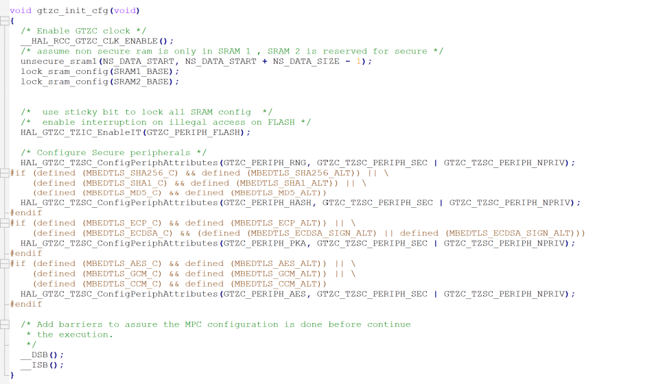

I suspected that my problem must be linked to a problem with SRAM2 and I'd already spent a long time thinking about it and your advice only reinforces that idea. The configuration in gtzc_init_cfg in target_cfg.c don't have the lines that you mentioned so I guess It's not a default configuration stuff isn't it ?
I have something like this :
I will try to understand more in depth about how all the SRAM2 is working but if you have any other suggestions they will be very welcome.

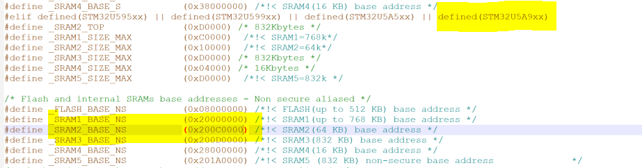

In the linker files, there is the region_defs.h file which include that : We have for STM32U5A9xx _SRAM2_BASE_NS defined as 0x200C0000 which is corresponding to
Does this means that it is well defined ? If not what do you mean by " you must be sure that STM32U5A5xx is defined"
