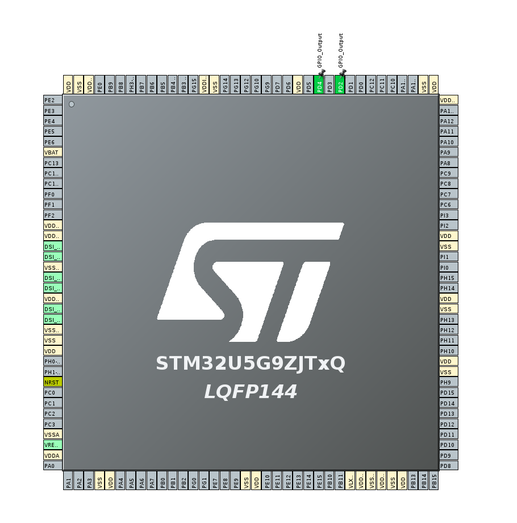

I only have 2 GPIOs activated, and the SMPS, not yet any code written from me...
The function HAL_PWREx_ControlVoltageScaling times out in NonSecure (somehow works if debugging and stepping into.. but then HAL_RCC_OscConfig get HAL_Error).
For some reason there is not problem if I call that SystemClock_Config in Secure main.c...
Any idea why this is happening ?
