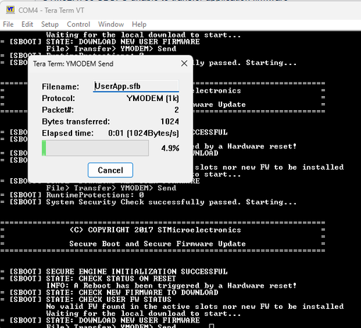

I'm using the 1-Image example code, All security feature were disabled by #define SECBOOT_DISABLE_SECURITY_IPS in app_sfu.h. I loaded SBSFU.elf onto the board and transferred the UserApp.sfb via YMODEM. At first attempt the user application transferred without issue. At later attempts, the transfer stuck at first couple of packets until it failed. This also happened to a second board.

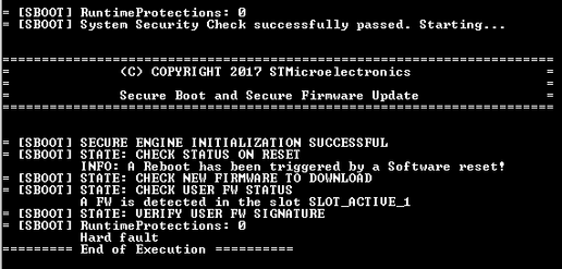

Using the debugger, it seems to be failing at SE_CRYPTO_ReadKey_Pub() inside the SE_CRYPTO_Authenticate_Metadata() function. I have no clue for the reason.
I tried a different approach by loading the final image "SBSFU_UserApp.bin" directly to the board and the program went into a infinite reset loop. From the debug, it failed at the same place.

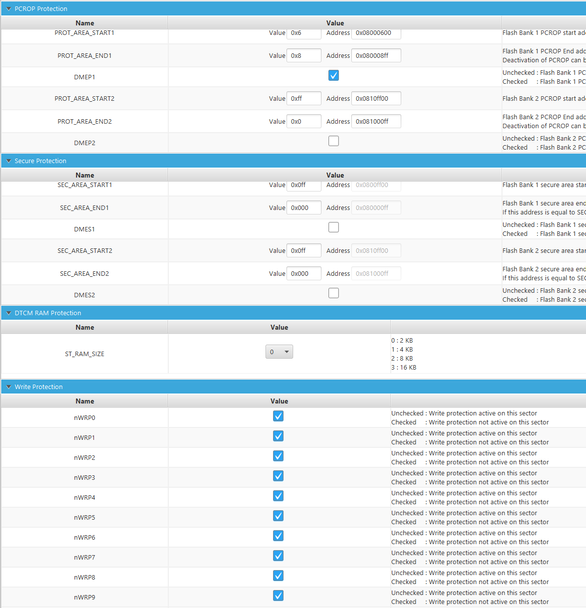

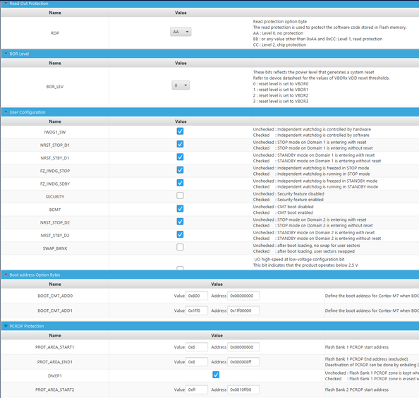

Because it used to work on the board but not later, I suspect there's something changed or misconfigured on my board. Here are the option bytes settings.

Hello @JZ ,
In option bytes, PCROP region is enabled.
You said you have disabled all protections. So, something is inconsistent.
Please try to remove the PCROP protection using RDP regression. Then flash again the big image.
I hope this will solve your issue
Best regards
Jocelyn
