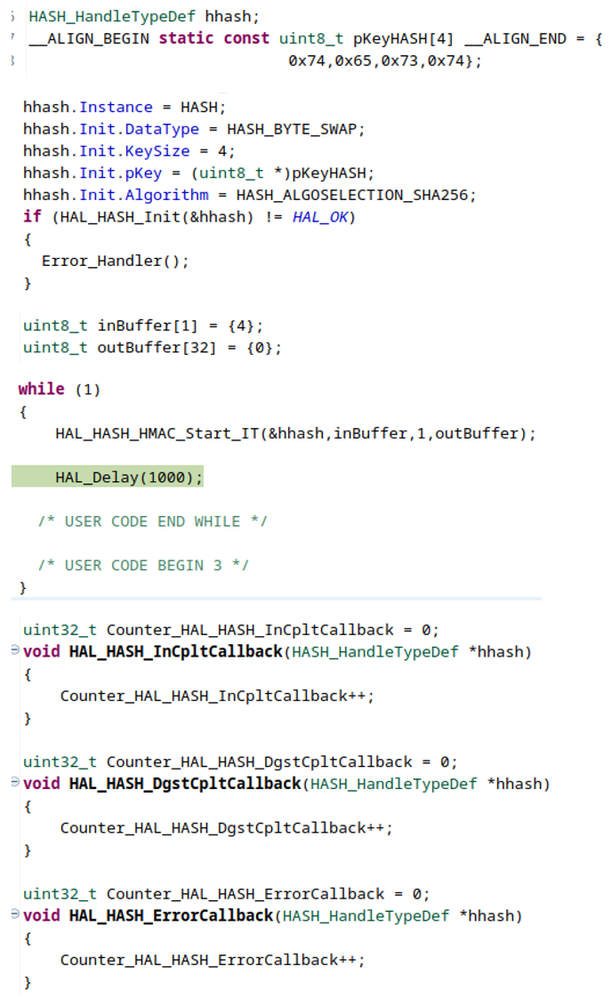

Hello, can someone explain the following behavior to me? Is this a bug or am I using the HAL incorrectly?
Thanks a lot.
Code snippet
The result

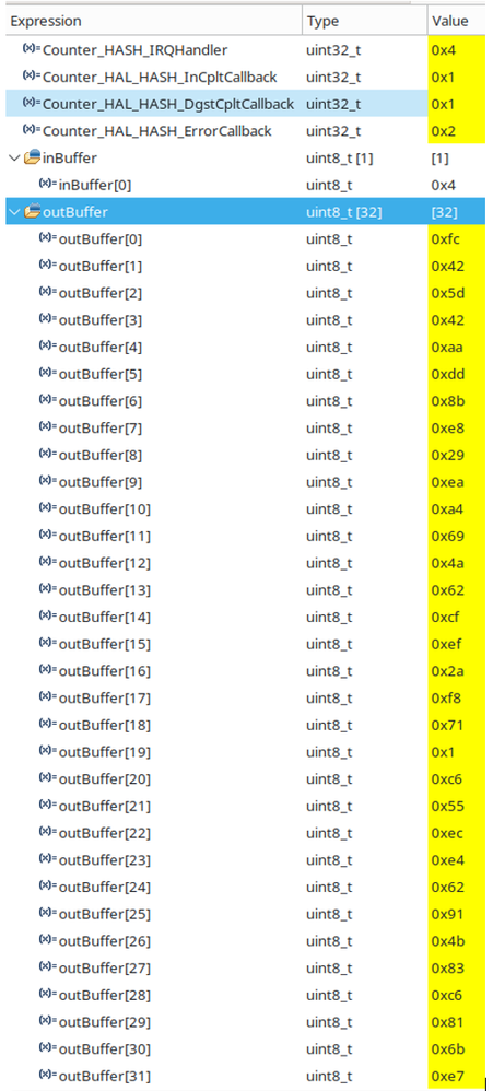

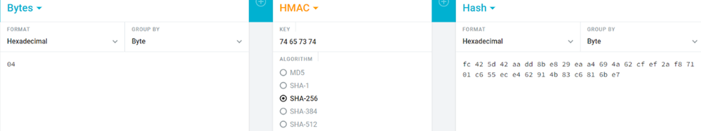

The result is correct, but the behavior is strange. I receive two error callbacks also.

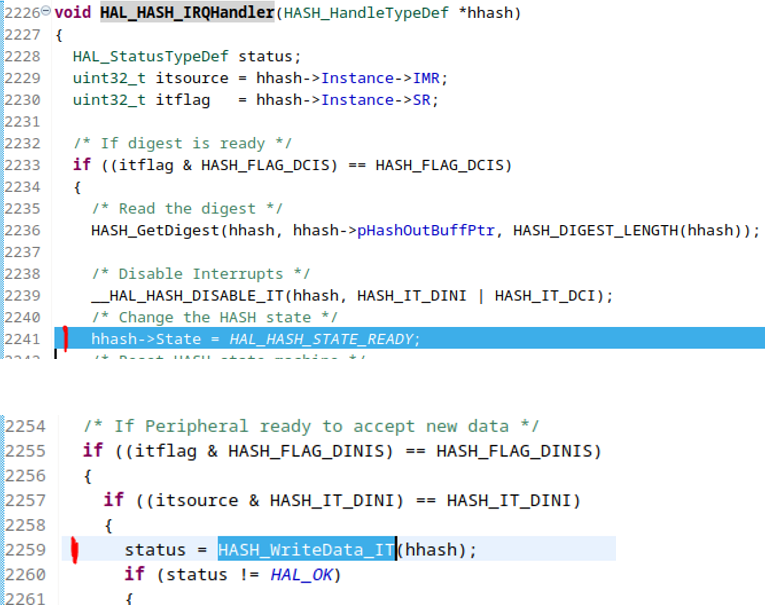

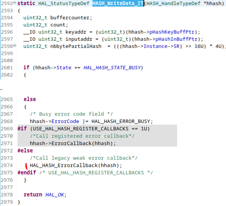

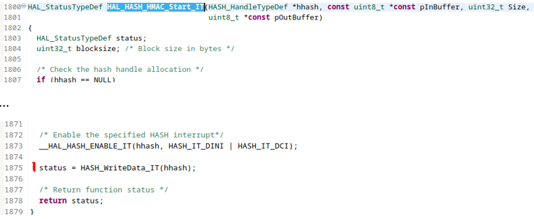

First HAL_HASH_ErrorCallback due to:
READY state leads to ErrorCallback
Second HAL_HASH_ErrorCallback due to:
2024-08-13 5:03 AM
