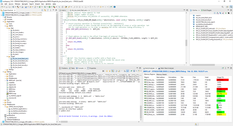

I try to build the STM32CubeExpansion_SBSFU_V2.6.2 for STM32H750B-DK. I use STM32CubeIDE Version: 1.9.0 on Windows 10.

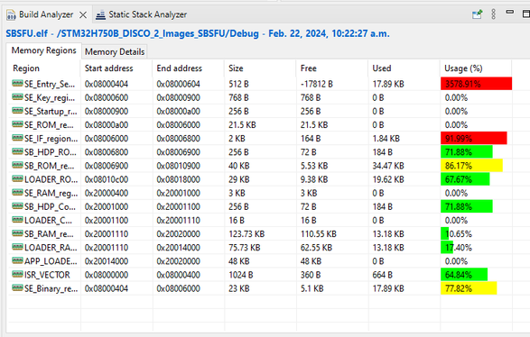

The build result is suspicious:
More details:
The first section is overflown by 3479%. What I did wrong? How to fix it?
The next question is about loading the code to the CPU's flash memory.

Hello @tarbal ,
the build overflow is normal. It is related to the way Secure Engine binary is integrated inside SBSFU build.
Application download can be done through Ymodem. You can use teraterm to do this.
