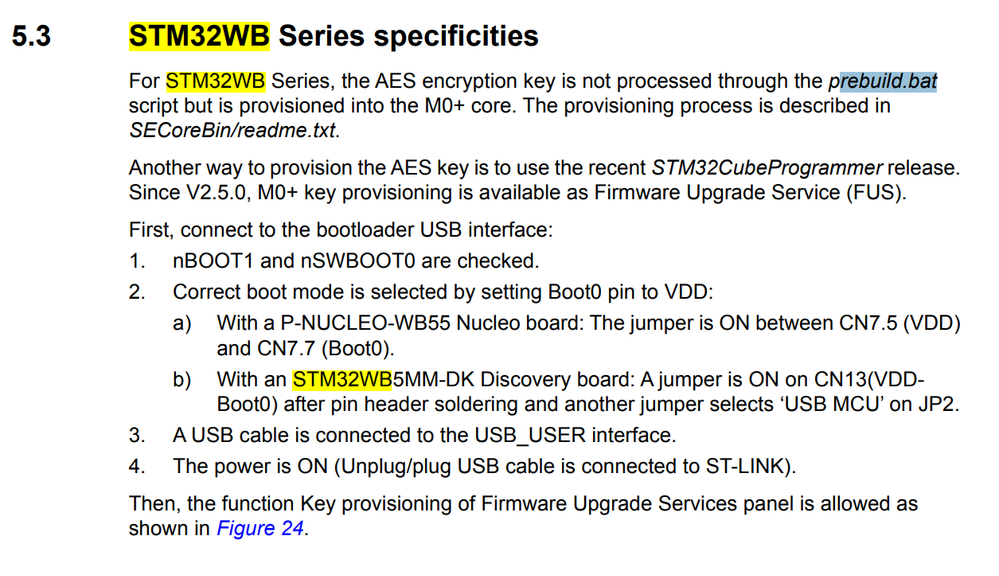

2024-05-07 10:04 AM
I expect this:
But I see that prebuild.bat edits se_keys.s
(Using X-CUBE-SBSFU 2.6.2 and folder 2_Images from P-NUCLEO-WB55.Nucleo).

2024-05-07 10:32 AM - edited 2024-05-07 10:48 AM
I see that SE_CRYPTO_AES_ReadKey uses SHCI_C2_FUS_LoadUsrKey in P-NUCLEO-WB55.Nucleo/Applications/2_Images/2_Images_SECoreBin/Src/se_crypto_bootloader.c. So, why is se_key.s edited and needed??
I have checked that is needed to access the public key of the asymmetric key. But is mandatory to contain the private key?
