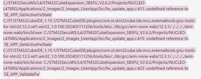

Hi @Jocelyn RICARD
I followed same step, but I am getting undefined reference error I added screenshot
 screen shot image1:
screen shot image 2: error log stm32 cubeide:
C:/STM32SecuWS/L4/STM32CubeExpansion_SBSFU_V2.6.2/Projects/NUCLEO-L476RG/Applications/2_Images/2_Images_UserApp/Src/fw_update_app.c:411: undefined reference to `SE_APP_GetActiveFwState'
C:/ST/STM32CubeIDE_1.15.1/STM32CubeIDE/plugins/com.st.stm32cube.ide.mcu.externaltools.gnu-tools-for-stm32.12.3.rel1.win32_1.0.100.202403111256/tools/bin/../lib/gcc/arm-none-eabi/12.3.1/../../../../arm-none-eabi/bin/ld.exe: C:/STM32SecuWS/L4/STM32CubeExpansion_SBSFU_V2.6.2/Projects/NUCLEO-L476RG/Applications/2_Images/2_Images_UserApp/Src/fw_update_app.c:415: undefined reference to `SE_APP_GetActiveFwState'
C:/ST/STM32CubeIDE_1.15.1/STM32CubeIDE/plugins/com.st.stm32cube.ide.mcu.externaltools.gnu-tools-for-stm32.12.3.rel1.win32_1.0.100.202403111256/tools/bin/../lib/gcc/arm-none-eabi/12.3.1/../../../../arm-none-eabi/bin/ld.exe: C:/STM32SecuWS/L4/STM32CubeExpansion_SBSFU_V2.6.2/Projects/NUCLEO-L476RG/Applications/2_Images/2_Images_UserApp/Src/fw_update_app.c:423: undefined reference to `SE_APP_ValidateFw'
collect2.exe: error: ld returned 1 exit status

Prakash_Raj1994
Associate III
Hi @jocelyn RICARD,
I Resolve the undefined refers error. after enabling flag. but when new firmware updated. not valid it should rollback to previous version. but it's not rollback.

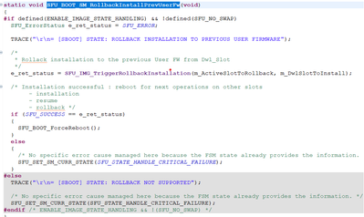

Changes made in code:
did I miss anything.

Jocelyn RICARD
Hello @Prakash_Raj1994 ,
I made the test on STM32L476 Nucleo.
There are 2 issues related to the activation of the image validation feature
1) The file Projects\NUCLEO-L476RG\Applications\2_Images\2_Images_SBSFU\STM32CubeIDE\se_interface.txt is missing the calls to SE_APP_ValidateFw and SE_APP_GetActiveFwState.
Here is the what should be the content of this file:
SE_APP_GetActiveFwInfo
SE_APP_ValidateFw
2) With default configuration, the validation will trigger a reset.
Reason is MPU configuration setting all the active slot as read only.
An easy way to fix it is to comment #define SFU_MPU_USERAPP_ACTIVATION in app_sfu.h
Best regards
Jocelyn

Jocelyn RICARD
I don't have such issue.
Here you seem to have a new firmware that is not valid, so installation does not even occur.
Please check if you didn't change anything mode compared to original example
Best regards
Jocelyn
