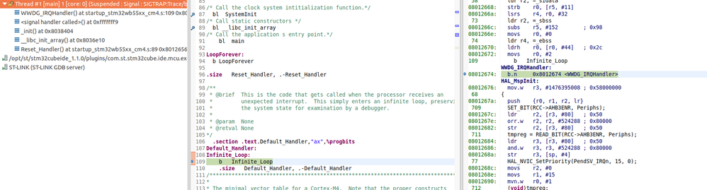

2020-08-29 3:56 AM
Hi @Jocelyn RICARD ,
Thanks for sharing the debug steps. Now we found that, it stuck at bl __libc_init_array call.
From startup_stm32wb55xx_cm4.s Stuck at infinite loop,
*bl __libc_init_array*
Default_Handler:
Infinite_Loop:
b Infinite_Loop [Function trace, is pointing to WWDG_IRQHandler ]

2020-08-31 5:42 AM
Hello Ali,
the answer is in your screen capture; WWDG_IRQHandler that has no implementation. This resulted in calling the default IRQhandler.
Do you activate the window watchdog in your code?
Best regards
Jocelyn
2020-08-31 9:05 AM
Be carefull , debuger and compiler use one code infinite loop for all error while 1 and mark it as WWDG_IRQHandler (first IRQ). But this isnt realy WWDG handler...
