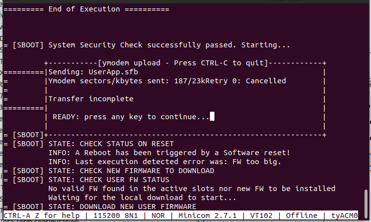

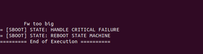

When flashed, the binary seems to function perfectly, but when I corrupt the image and attempt to upload a new sfb file the board keeps failing the download saying that the firmware is too big.
The project I am working on is largely unmodified other than setting the flags for the minicom communication in app_sfu.h and the workaround for the double include for the userapp.
Below are screenshots of the problem:

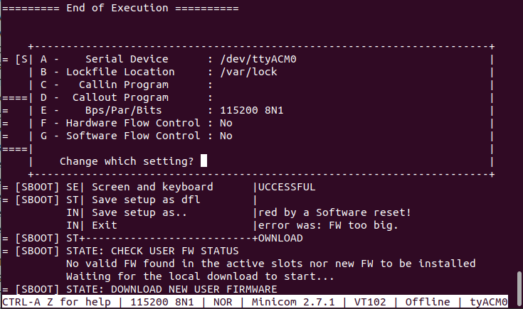

I have verified that minicom is indeed configured correctly as the guide requires:
Is there something I am missing? Yes, I have read the integration guide and I have modified the project to support the dual core board.

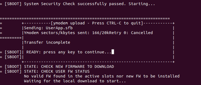

2024-03-20 9:10 AM
I am also adapting the NUCLEO-H753ZI single-slot project to work on a NUCLEO-H743ZI2 board and got the same error using minicom on linux.
How did you fix it?

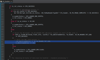

2024-03-20 1:02 PM
Shifting the DWL area pointer by the received header size (192 bytes) fixed the issue for me.
