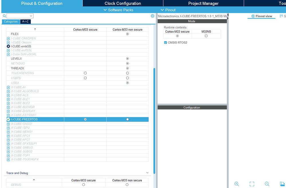

I used STM32CubeIDE (Version: 1.12.0) for development. I've seen RTOS-based selection, but I haven't seen the RTOS configuration parameter (safety-critical parts). I've provided a screenshot to this thread.

2) The usual use of the TrustZone isolation is that secure part is a secure boot (non-upgradeable) along with some cryptographic library, platform attestation or secure storage. The RTOS is usually running in non-secure part, only calling for secure services when needed.
There are two stacks, so it could be possible to have 2 RTOS, but why? There is no advantage in doing that, only problems.
I suggest to use TF-M based SBSFU for the secure part and RTOS of your choice for the rest.
