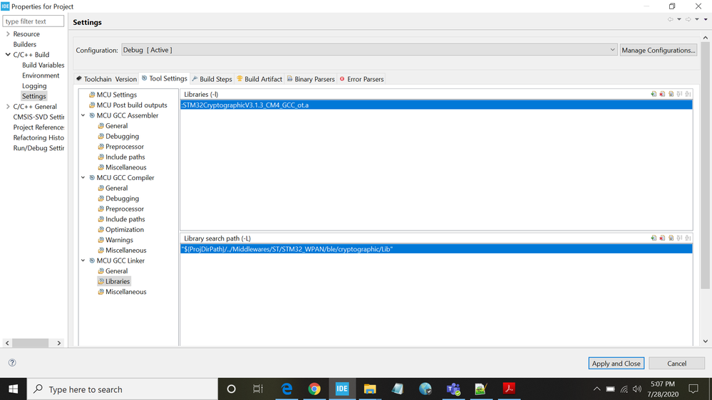

4. Go to Libraries tab under MCU GCC Linker
Add following path
a. => :STM32CryptographicV3.1.3_CM4_GCC_ot.a under Libraries
b. => "${ProjDirPath}/../Middlewares/ST/STM32_WPAN/ble/cryptographic/Lib"

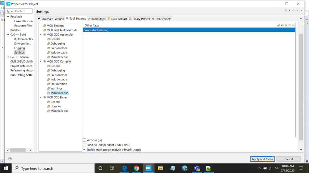

6. Go to Miscellaneous tab under MCU GCC Compiler
Add following flag
-Wno-strict-aliasing

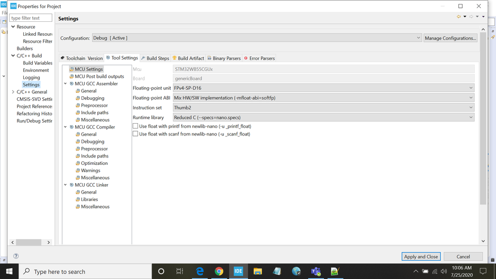

7. Check following setting under MCU Settings
a. => Floating-Point ABK - Mix HW/SW implementation

when changing the library to the …GCC_ot.a, CubeIDE requires the FPU to be a mix for the crypto lib.
