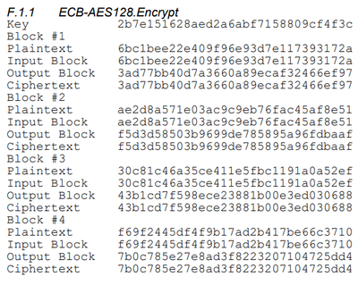

I have tested AES Encryption in the TX side and found that the encrypted data is not same as that mentioned in the https://nvlpubs.nist.gov/nistpubs/Legacy/SP/nistspecialpublication800-38a.pdf file. Is there any configuration mismatch for the encryption?
I have got the output as follows:
Actual Data:
6b c1 be e2 2e 40 9f 96 e9 3d 7e 11 73 93 17 2a
Encrypted Data:
7c 64 5e ae 8 8d 5b 97 10 bc 96 a9 9 35 e1 4b
Code is as follows:

hello @sandeep_kumar_v,
The NIST vector example is 16 bytes long, so there is no need for padding.
If you are declaring the NIST plaintext as a byte array:
uint8_t tmp [] = { 0x6b, 0xc1, 0xbe ,0xe2 ,0x2e ,0x40 ,0x9f ,0x96 ,0xe9 ,0x3d ,0x7e ,0x11 ,0x73 ,0x93 ,0x17 ,0x2a} ;
Change the data type to enable BYTE swapping as follows:
  hcryp.Init.DataType = CRYP_DATATYPE_8B ; // BYTE_SWAP
