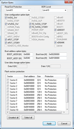

If I use the ST_LINK Utility I can read and write the memory without problems. The configuration of the Option Bytes is:

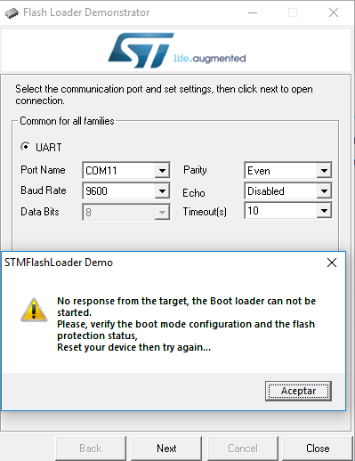

Hi, I am also trying to use the internal bootloader but in my case I do not even stablish conection with the board, the error says to verify the boot mode configuration because the Boot loader cannot be started (image attached). I have connected boot0 and boot1 to '1' and '0' respectively and connected the board with usb and got virtual COM11, but fails. What else should I do? I tried all baudrates but nothing.
2018-10-04 5:27 AM
