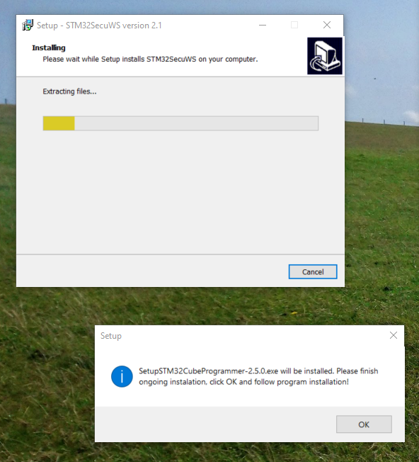

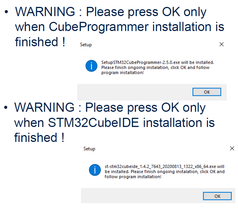

The installation instructions give dire warnings not to press OK until the installation has finished:
and, indeed, the popup appears - saying "finish the ongoing installation":
But the popup blocks the installation from proceeding - all progress stops!!
So what am I supposed to do?

In the installation instructions:
The actual installer:
there it stops - should I press OK, or should I follow the instructions ... ?

Hello Andrew,
Explanation : the installer launch installation of STM32CubeProgrammer but installer can't detect this installation is finish to install the next software component. This is to explain the warning.
What you need to do :
launch installer
first it will launch STM32CubeProgrammer installation. When installation of STM32CubeProgrammer is finished click on OK.
Then it will launch installation of STM32CubeIDE installation. When installation of STM32CubeIDE is finished click on OK
If you still face issue, let us know and we can organize a quick help session
2020-11-19 2:20 AM
"the installer launch installation of STM32CubeProgrammer but installer can't detect this installation is finish"
I guess that's the intention - but it's not working that way.
The installer is not launching the installation until I OK the message!
This is on Windows10-Pro.
I ignored what the message says, and just pressed 'OK' - and all the installations appear to have completed.

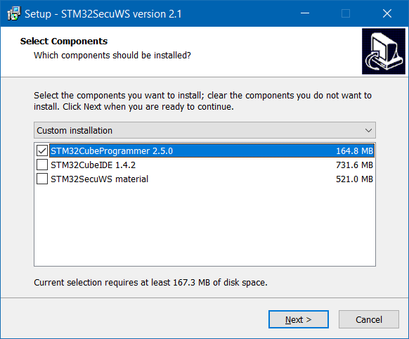

2020-11-19 3:55 AM
So I ran the STM32SecuWS setup again, and selected only the Cube Programmer:

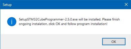

Again, this message appears:
But that stalls the installation - nothing happens so long as that message is displayed.
I have to click the 'OK' to get the installation to start.
But, once I click OK, it does seem to proceed.

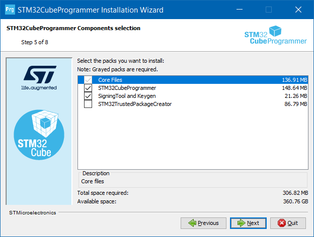

This dialogues is not mentioned in the PDF:
Should the 'STM32TrustedpackageCreator' be checked?
(I did check it, just in case...)
The CheckEnv.bat does now confirm that STM32CubeProgrammer v2.5.0 and SBSFU installations are OK.
Is there anything else I can do to verify that everything is fine?
