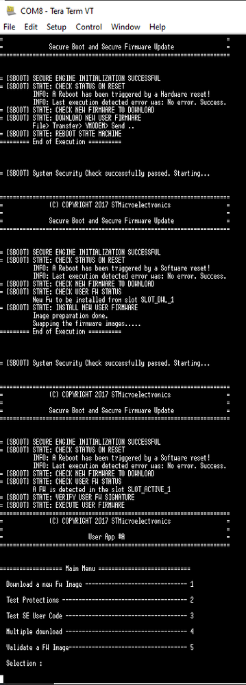

Thank you for getting back.
I made some progress. After implementing all of the above points. I get this on the comms window.
=       (C) COPYRIGHT 2017 STMicroelectronics         =
=       Secure Boot and Secure Firmware Update        =
= [SBOOT] STATE: WARNING: SECURE ENGINE INITIALIZATION WITH FACTORY DEFAULT VALUES!
========= End of Execution ==========
Then processor reboots and message repeats.
I tried debugging by stepping through the code however, it steps through the code very strangely I think its due to the missing secure engine code the debugger gets confused.
Fails at SFU_BOOT_Init(); in sfu_boot.c and e_ret_code = SFU_BOOT_INIT_FAIL is returned.
EDIT : Update
I think the issue was related to my custom board, I have been more successful with the STM32 NUCLEO board.
