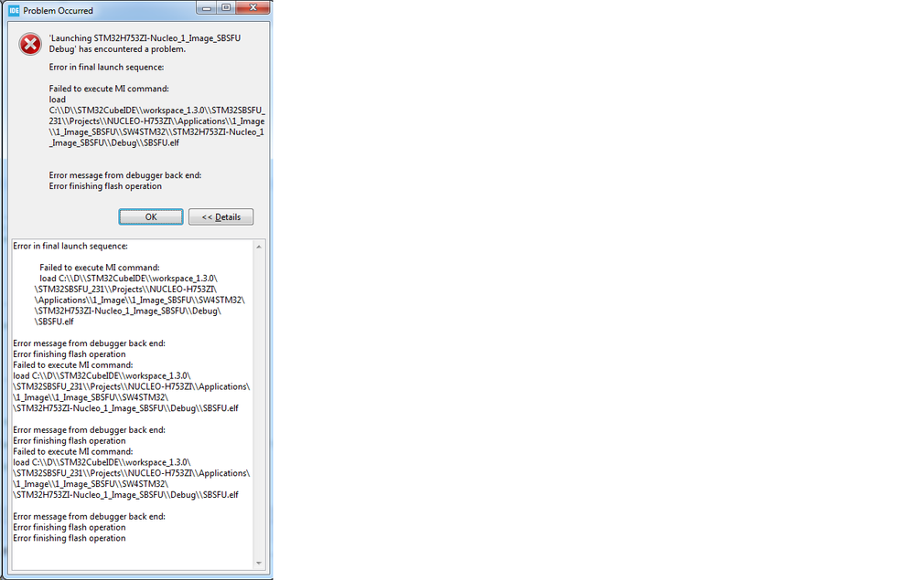

Hi Everyone, after trying to port the H753 to H755(Someone else had borrowed my H745 but both of them are extremely similar), I was still not able to sucessfully execute the full process SBSFU example. I was able to load SBSFU but it is still not able to reach the part where it prints out to the serial terminal. There was an instance where I was able to run the example in debug on the IDE but after some flashing a few times, I have been getting an error when trying to run it in debug.
The console of STMCubeIDE says:
Download verified successfully
Target no device found
Error in initializing ST-LINK device.
Reason: No device found on target.
Failed to restart ST-LINK connection
Error in STM32CubeProgrammer
Error in executing 'detach' command ...
Debugger connection lost.
Shutting down...
The following pop up appeared.
Unfortunately once this has been triggered, I am not able to execute or run the board in debug anymore and it has made it even harder.
Has anyone encountered this before because I cant seem to find much on this in other threads and it is blocking me from progressing.
Thanks in advance for any help !

Btw, one can use Alt+PrtScn for a snapshot of active window. :)
2020-07-22 8:17 PM
In fact that was what I did, what I didnt do was resize the popup before I closed it :grinning_face_with_sweat: .

could you try using STM32CubeProgrammer to fully erase the board?
Maybe you didn't deactivate the protections in SBSFU (app_sfu.h), leading to protection activation.
Best regards
