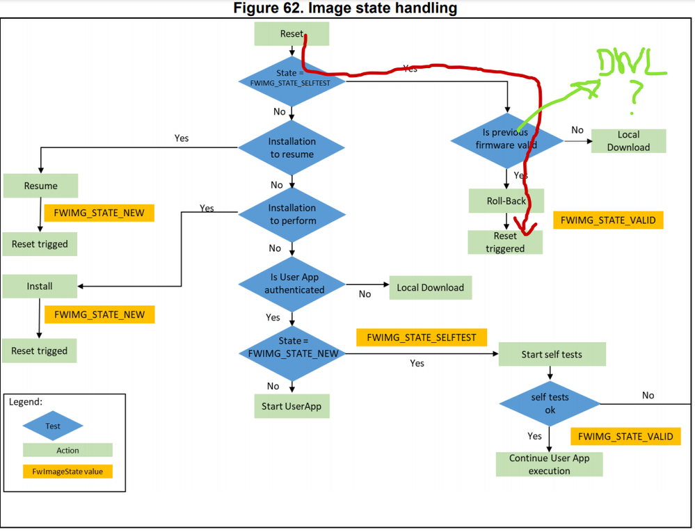

Hi @JHOUD, thanks for your answer and for the reference to Appendix J. I did not know it existed.
I've attached the flow image, combined with poor drawing skills. So looking at my output log and the flow, I guess my scenario follows the red line. A couple of follow-up questions:

2021-06-01 7:52 AM
Hi @ac_gd ,
yes, the red line shows the flow that I believe describes best your case.
The flow is high-level, it's easy to see that not all code branches are included, only those needed to understand the underlying principle. So in reality I'd say the error message is generated in between.
