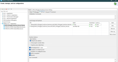

2025-02-18 10:31 PM
Sir I followed this step but the highlighted step is not working in stm32cube ide and the steps after that is more confusing.
2025-02-19 8:41 AM
Hello @Shubham08 ,
the point is to have both loaded, which for some reason is not default.
It's easier in normal commercial IDE.
BR,
J
