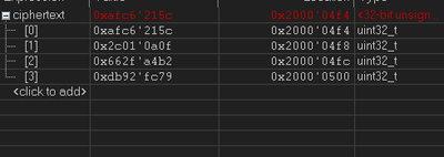

 here is the calculated cipher with the script:
and here is the calculated cipher with the MCU:
Regards
