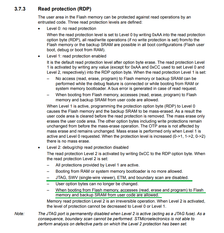

I tried to disable the JTAG by setting the RDP to level 2. It has disabled the JTAG access But I have flashed an application in internal flash which allows me to read and write internal flash using UART Now I am not able to read or write the internal flash. Will the RDP level 2 stop the access(read/write) to internal flash by the internal program also? I don't know what should I do now?
Here is what the datasheet says: In RDP level 2, I understand that flash read and write should be disabled via JTAG but Flash read or write should be allowed by an internal application/program stored in the internal flash.

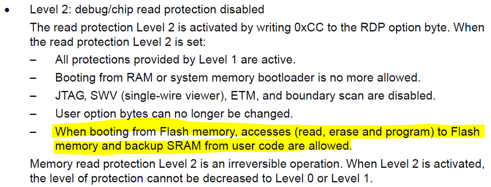

No, it does not. See reference manual:
I'm sure you've got something else going on there, which you're not going to be able to solve let alone debug due to RDP level 2.
