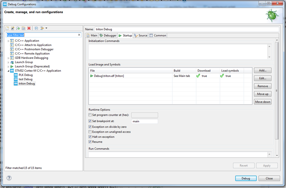

Tell me how can I download the firmware with the checksum in debug mode via stm32cubeide?
I don't have the "user file" field where I could write the path to the firmware with the checksum.

Hi ,
Please follow Steps 7 through STEP 11 to download an HEX file add new line with file and only download the .hex file and for .elf file do not download but "Load Symbols"
https://github.com/ethanhuanginst/STM32CubeIDE-Workshop-2019/tree/master/hands-on/06_F746-DISCO-CRC
