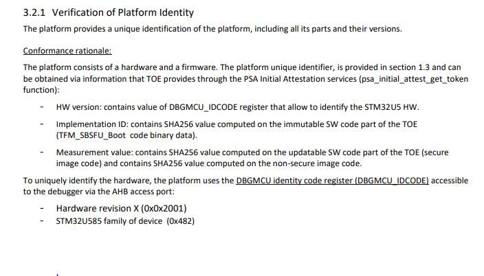

Please advise how to verify token generate by "psa_initial_attest_get_token".
My test kit is B-U585I-IOT02A and test application is TFM.

Hello @zqizh.1 ,
I advise you to have a look at this document:
Security Target for STM32U585 family of device compliant with SESIP profile for ARM PSA Level 3 chip, it may helps you on your question.
