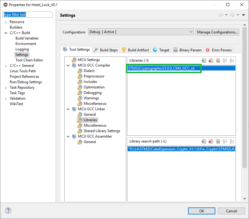

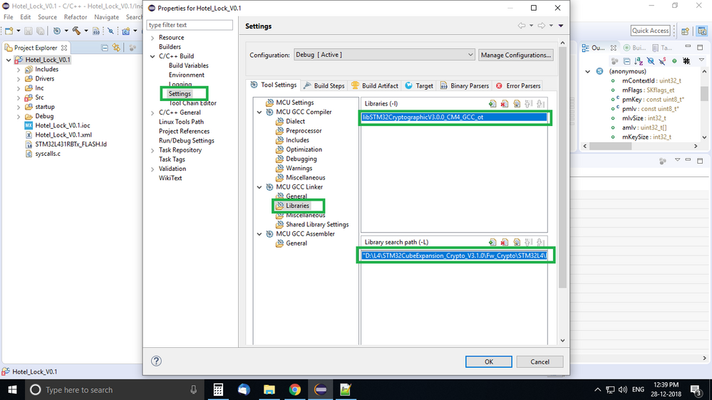

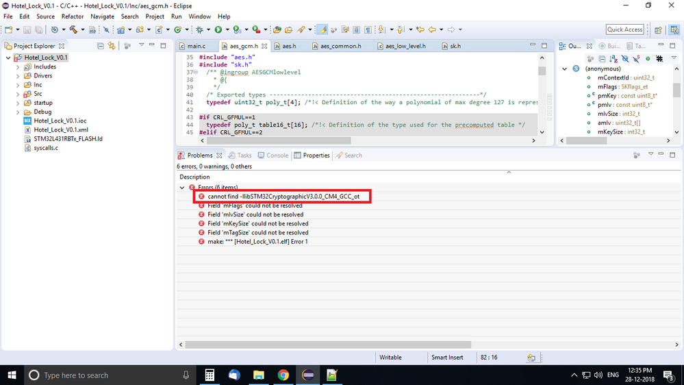

I have Downloaded STM32CubeExpansion_Crypto_V3.1.0 library. I am trying to use it for STM32L431RBTx Microcontroller. But I am getting error as shown in following images.
What am I missing to do?Please help.
Building target:
_V0.1.elf" @"objects.list" -llibSTM32CryptographicV3.0.0_CM4_GCC_ot -lm
c:/ac6/systemworkbench/plugins/fr.ac6.mcu.externaltools.arm-none.win32_1.13.2.201705091103/tools/compiler/bin/../lib/gcc/arm-none-eabi/5.4.1/../../../../arm-none-eabi/bin/ld.exe: cannot find -llibSTM32CryptographicV3.0.0_CM4_GCC_ot
collect2.exe: error: ld returned 1 exit status

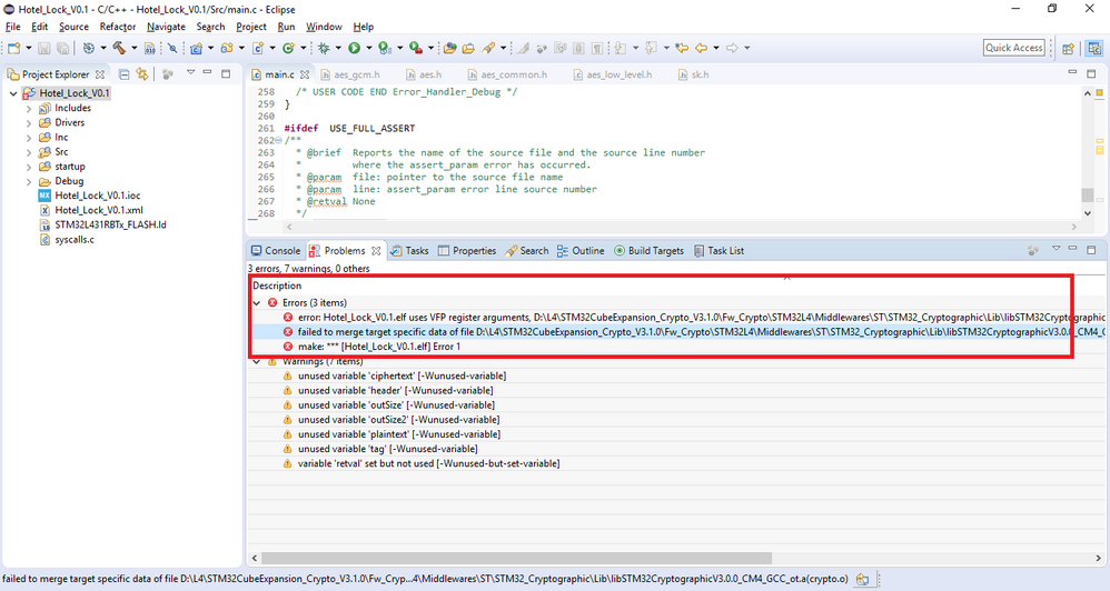

I have also tried by removing the prefix 'lib' from library .a file name. Then I am getting following error.
Invoking: MCU GCC Linker
arm-none-eabi-gcc -mcpu=cortex-m4 -mthumb -mfloat-abi=hard -mfpu=fpv4-sp-d16 -L"D:\L4\STM32CubeExpansion_Crypto_V3.1.0\Fw_Crypto\STM32L4\Middlewares\ST\STM32_Cryptographic\Lib" -specs=nosys.specs -specs=nano.specs -T"../STM32L431RBTx_FLASH.ld" -Wl,-Map=output.map -Wl,--gc-sections -o "Hotel_Lock_V0.1.elf" @"objects.list" -lSTM32CryptographicV3.0.0_CM4_GCC_ot
c:/ac6/systemworkbench/plugins/fr.ac6.mcu.externaltools.arm-none.win32_1.13.2.201705091103/tools/compiler/bin/../lib/gcc/arm-none-eabi/5.4.1/../../../../arm-none-eabi/bin/ld.exe: error: Hotel_Lock_V0.1.elf uses VFP register arguments, D:\L4\STM32CubeExpansion_Crypto_V3.1.0\Fw_Crypto\STM32L4\Middlewares\ST\STM32_Cryptographic\Lib\libSTM32CryptographicV3.0.0_CM4_GCC_ot.a(crypto.o) does not
c:/ac6/systemworkbench/plugins/fr.ac6.mcu.externaltools.arm-none.win32_1.13.2.201705091103/tools/compiler/bin/../lib/gcc/arm-none-eabi/5.4.1/../../../../arm-none-eabi/bin/ld.exe: failed to merge target specific data of file D:\L4\STM32CubeExpansion_Crypto_V3.1.0\Fw_Crypto\STM32L4\Middlewares\ST\STM32_Cryptographic\Lib\libSTM32CryptographicV3.0.0_CM4_GCC_ot.a(crypto.o)
make: *** [Hotel_Lock_V0.1.elf] Error 1
2018-12-28 3:01 AM
The new issue is related to the Floating point support.
You need to use another Library built with the support of FPU:
\STM32CubeExpansion_Crypto_V3.1.0\AccHw_Crypto\STM32L4\Middlewares\ST\STM32_Crypto\Lib\libSTM32CryptographicV3.0.0_CM4_GCC_FPU.a
2018-12-28 2:36 AM
This is a link issue, please try to use STM32CryptographicV3.0.0_CM3_GCC without "lib" in the Library name.

2018-12-28 2:40 AM
Thanks for your reply Amir. I tried that one also. but getting different error after that.
2018-12-28 3:01 AM
2018-12-28 3:09 AM
Thank you so much Amir for your instant reply. Support of FBU worked. Project built successfully.
