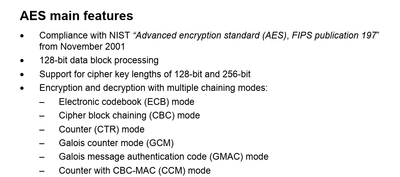

If you want more security for the data: same as always , use encryption ; read about using the AES etc. in rm:

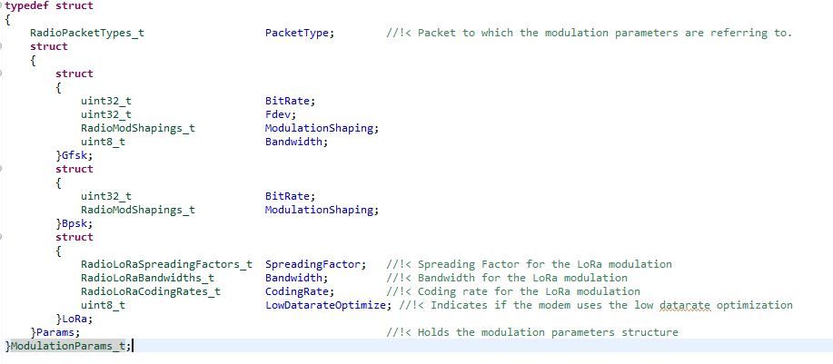

I have used Lora modulation parameters.
Please use this button to properly post source code - not as an image:
