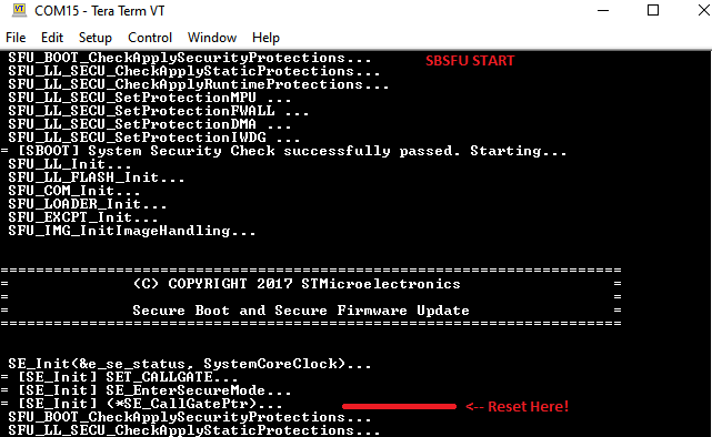

When the Secure Engine Call (inside SE_Init() function) is called in this line:
e_ret_status = (*SE_CallGatePtr)(SE_INIT_ID, peSE_Status, primask_bit, uSystemCoreClock);
(which is between a SE_EnterSecureMode and SE_ExitSecureMode).
The MCU resets at this point, the reset happens continuously (reset loop) always at this line. The code executed until after SE_EnterSecureMode(&primask_bit); is called. I have added TRACE calls to check this.

TRACE("\r\n= [SE_Init] (*SE_CallGatePtr)..."); //RESET HAPPENS BELOW:

I have no idea what is happening. I'm not even sure it's the firewall spurious reset. I disabled SFU_FWALL_PROTECT_ENABLE define and the same issue persists. Also if it was an actual firewall (or other reset) I would get the TRACE printout telling me that. This is just a inexplicable reset.
Any help is appreciated. It's a complete showstopper with SBSFU.
