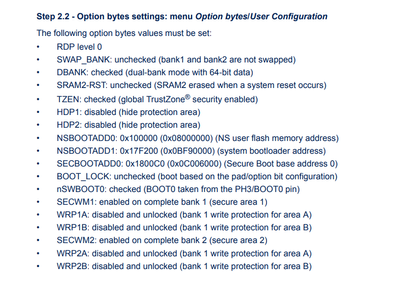

The issue was solved i tried the option byte configuration as described in section 10.2 of UM2851

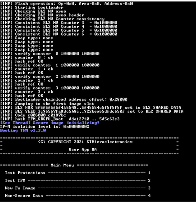

i used git bash to run .sh files in windows system. Now i am able to get TF-M Output on tera term screen

But even after this i reset the board and opened tera term and tested the output but nothing is being displayed. Can anyone suggest the possible issue here and how to resolve the error.
