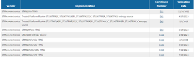

Here is a capture
Then from this page you can access to certification documents.
For the U545 this is this page
From this you can access to the associated document by clicking on Public Use Document.
In this document you will find the RNG configuration used.
