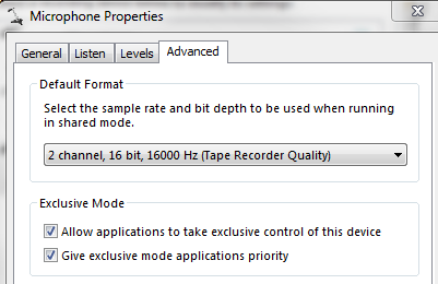

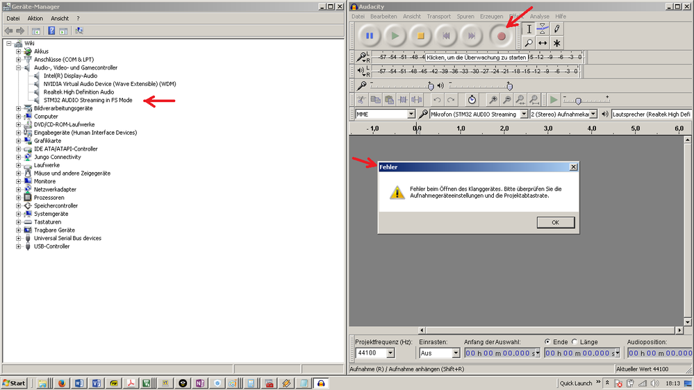

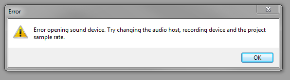

Now, if you have an error message like this one:
You have to update the microphone properties to select the 2 channels, 16 KHz option:
I will keep you updated about the status of the checks.
-Amel

When using the .bin version, it will stream at 16KHz and the microphone will be recognized by Wiindows as a 16Khz, 2ch mic.
When using the firmware package, the default sampling frequency is set to 8Kz. So you will need to update the advanced options for the STM32 microphone to change the sampling frequency (as shown in my previous post to set 8000 Hz this time).

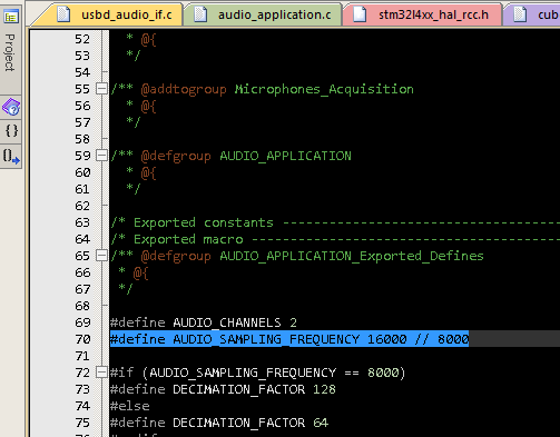

You can also set to 16000 the AUDIO_SAMPLING_FREQUNCY macro in the “audio_application.hâ€� file.
