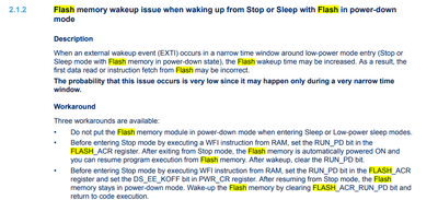

Hello @Brigei
check STM32L031xx/L041xx device errata - Errata sheet section 2.1.2 :
2024-07-02 10:09 AM
Hi @Sarra.S ,
IMO the quoted erratum does not apply to this case:
The erratum talks about invalid FLASH fetch. This is obviously not the case here: the first FLASH fetch after wakeup is the interrupt vector fetch, and that is obviously correct, as execution reaches the ISR. The problem is the incorrectly stacked registers. In other words, the problem is *not* FLASH fetch, the problem is *register stacking in SRAM fails*, i.e. it's the SRAM which is problematic after wakeup.
2024-07-03 3:44 AM - edited 2024-07-03 4:17 AM
Hey @waclawek.jan,
This is related to the flash wakeup time when the system is waking up from LPSLEEP.
The first instruction fetch from Flash after waking up is incorrect due to the Flash not being ready (as described in the errata, recovery time is needed), the POP that attempts to restore the PC from the stack could end up fetching the wrong address for the PC, and the CPU will resume execution at an incorrect address leading to hardFault.
As the workaround suggest and I think @Brigei tested it, removing the line that puts the flash in power down mode will solve the issue.
