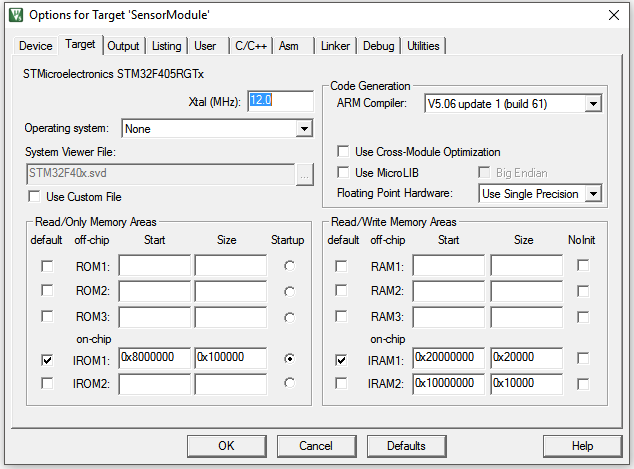

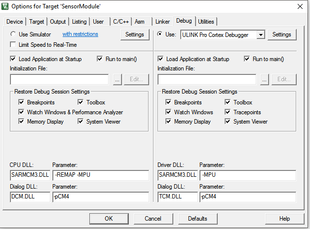

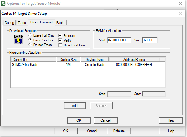

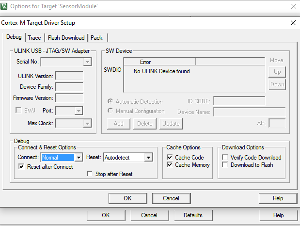

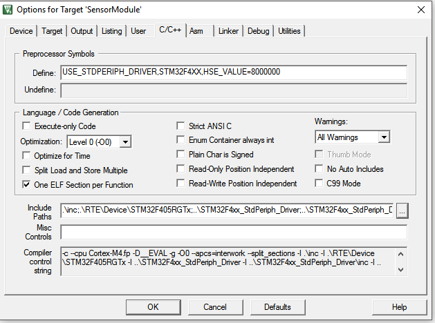

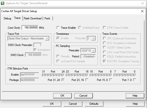

When I start the device it wont run. And then when I hit the restart button it works. It also works perfectly in debugg. So I have no idea why this is happening. It is a self made PCB, and we are using an STM32F405RG. I am using Keil, and have no idea if it is correctly setup. I also am not sure if the heap(0x00000200) and stack(0x00002000) size are correct. Here is a few pictures that may help:2016-07-10 6:18 AM

If you have a 12 MHz crystal make sure the PLL settings in system_stm32f4xx.c reflect that, and HSE_VALUE too.
