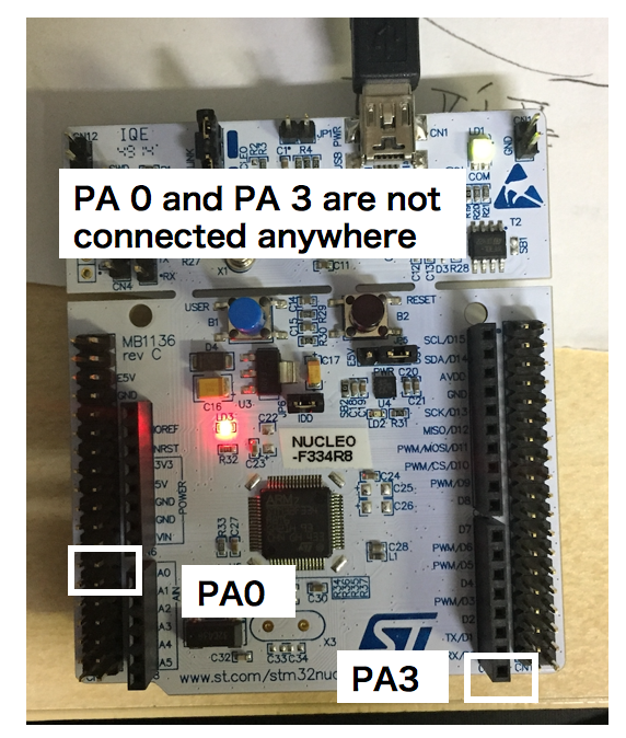

I'm using STM32F334Nucleo.
Nucleo's PA 3 terminal indicates about 3.3 V in ADC in a situation where nothing is connected.
On the other hand, the PA0 terminal shows about 0V in the AD conversion in a situation where nothing is connected.
Why do these two differ?

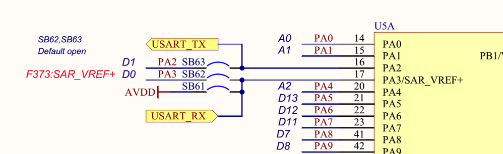

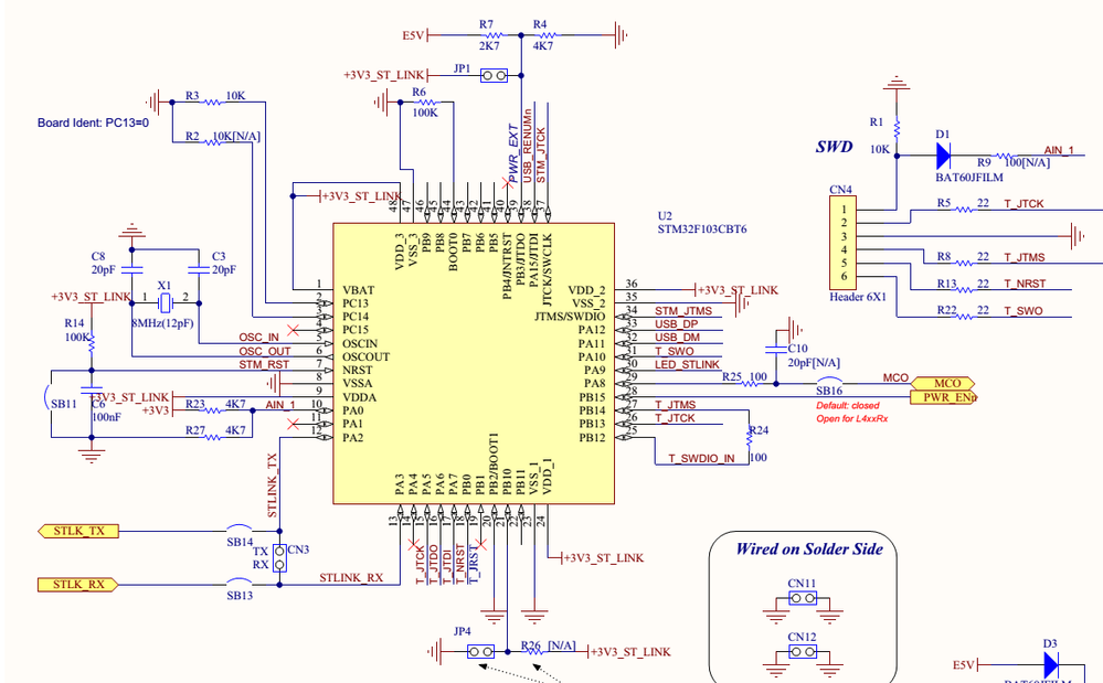

Probably because it is connect to the VCP USART from the ST-LINK. Review the schematic
2017-07-24 5:49 PM
2017-07-24 5:57 PM
this is your target mcu
belowed is your st-link
you should probably removed SB13 and connect SB62
