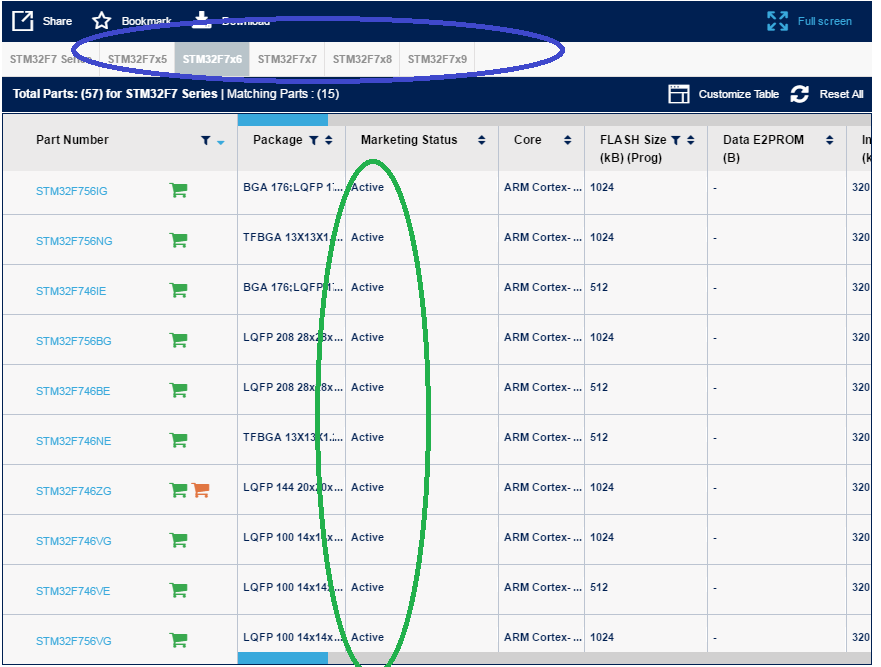

Hi Calvin63,
It is mentioned in the application note ''Migration of microcontroller applications from STM32F42xxx/STM32F43xxx to STM32F74xxx/STM32F75xxx? :?The STM32F74xxx/F75xxx devices are fully pin-to-pin compatible with the STM32F42xxx/F43xxx devices except for the LQFP100 package..?
So for your case, with STM32F427IIT 6(LQFP176), you will be fully compatible with STM32F74xxx/F75xxxFor the website , you can see the STM32F7 details in the dynamic table of product? Parts inside the
: as you see in figure bellow, in the blue circle the possible selection of derivative micros and in green circle the marketing status.

Hi:
