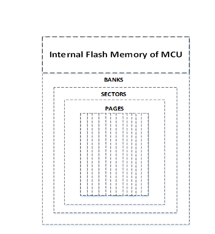

2023-06-05 1:50 AM - edited 2023-11-20 4:01 AM
whether this below image is my imagination about memory
please correct me or help me in understanding this
2023-06-05 4:27 AM
Sizes depend on STM32 family / model.
Generally have banks and pages.
2023-06-05 10:19 AM
On some STM32 sectors have different sizes inside the same chip...
2023-06-05 12:06 PM
Generally sectors / pages / blocks is a term used interchangeably or loosely.
On the F4 / F7 the erase size varies, along with the time, banks can also be arranged side-to-side rather than back-to-back.
A single power-point slide really doesn't capture the complexity or choices.

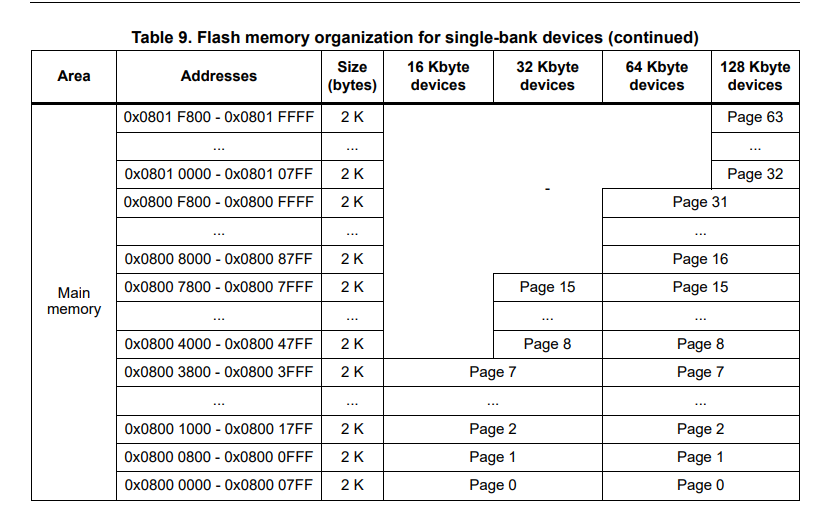

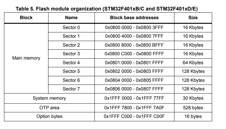

2023-06-06 1:48 AM - edited 2023-11-20 4:01 AM
below memory organisation of stm32f4,stm32G0.In F4 it is organized as sectors whereas G0 advanced Arm it is defined as Pages
