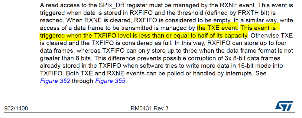

The excerpt in the original reply says TXE is triggered when the TXFIFO is less than half full.

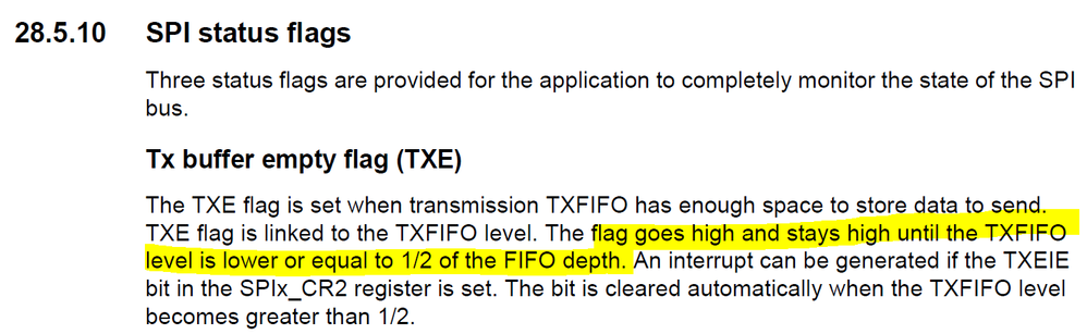

This excerpt says TXE is triggered when half-full or less:

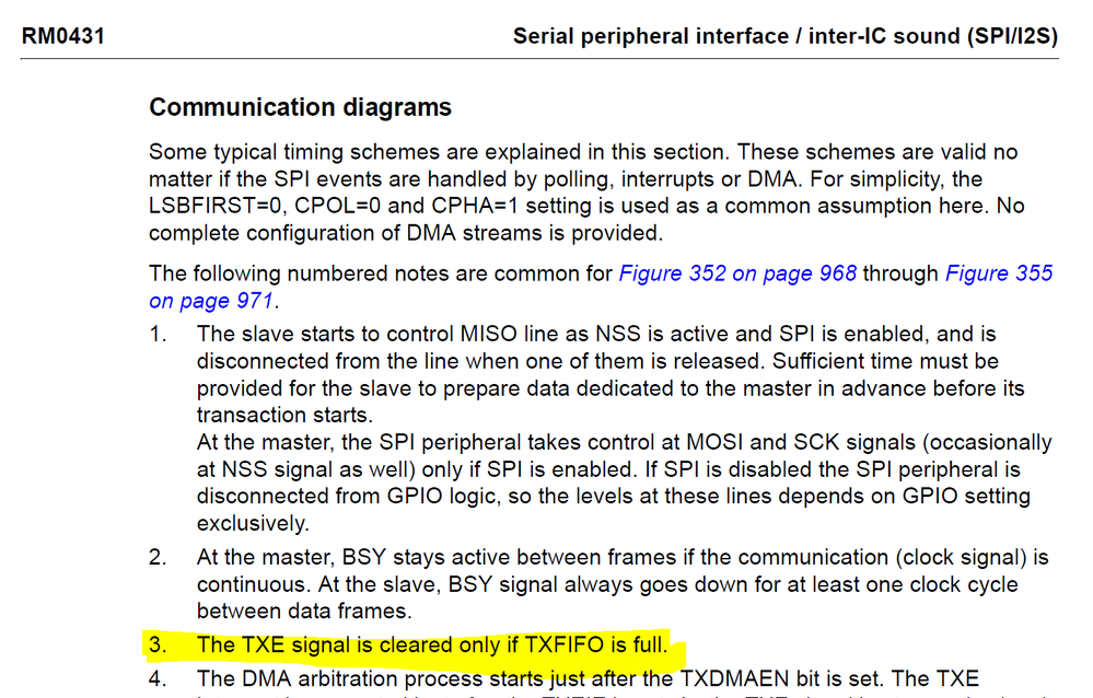

This one says it's only cleared when TXFIFO is full:
