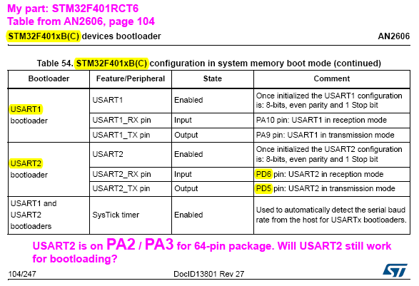

On the 64-pin STM32F401RCT6 there are two USARTs:
  • USART1 on ports PA9 and PA10, pins 42 and 43
  • USART2 on ports PA2 and PA3, pins 16 and 17
I would think that either of these could be used by the bootloader, since the bootloader generally talks about USART1 and USART2.
However, AN2606 specifies that USART2 is on PD5/PD6 (correct for 100-pin package, there is no port D on 64-pin package).
So can USART2 be used for the serial bootloader in a 64-pin STM32F401RCT6 / STM32F401xB(C)  ?

Posted on August 10, 2016 at 17:48
I'd assume only USART1 PA9/PA10 would be viable, and design accordingly.
You can use whatever USART and pins for your own application implementation

Posted on August 10, 2016 at 19:37
Thanks for the reply.
Yes, we have planned for that. It just seemed more likely to me that it was a failure to update documentation from the 100 pin package to the 64 pin package rather than an obtuse decision to limit the number of boot options in the 64-pin package.
Maybe we will build with some test points to verify that USART is truly not available for serial boot loader.
Posted on August 10, 2016 at 21:28
I think it is more a function of having one ROM Boot loader for the die regardless of what package it ends up in. You pick a lower pin count package, your escape options diminish.
I'd go with the premise that it functions as documented, and PA2/PA3 isn't an option.

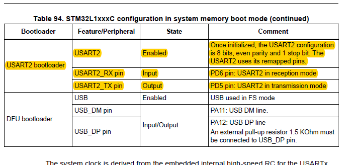

Can somebody explain what this line means?
''The USART2 uses its remapped pins.''
I'm using STM32L151CCU6 which doesn't have PD6/7. The bootloader isn't ack'ing when PA2/PA3 is used. Shouldn't the PA2/PA3 be the ''remapped pins'' for this case?
