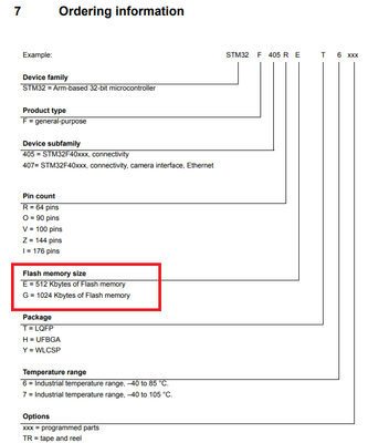

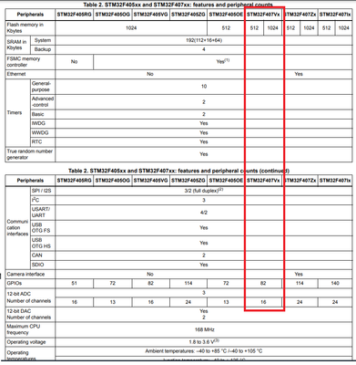

2024-03-28 12:37 AM - edited 2024-03-28 1:09 AM
STM32F407VET
STM32F407VGT
The only difference is the Flash memory size:
E: 512kB
G: 1024kB
Refer to the datasheet:
STM32F407VET
STM32F407VGT
E: 512kB
G: 1024kB

2024-03-28 1:07 AM - edited 2024-03-28 1:12 AM
There is no differences except the Flash memory size.
Since VGT has more Flash than VET, VGT can replace VET without any issue.
