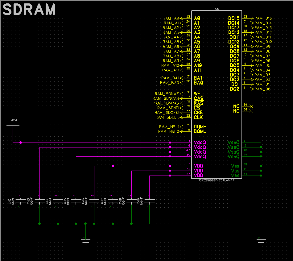

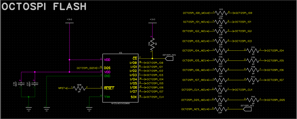

I am using below commponet
MCU: STM32H7B3IIT6
SDRAM: IS45S16800F-7CTLA1-TR
FLASH: MX25LM51245GMI00
I am revising the card design according to high speed signals. But how do I calculate the length of the paths to be drawn for SDRAM and FLASH?
How many mm and how much impedance should it have?
2022-04-23 3:59 AM
The shorter the better, but it's more important for all related signal lines to be of the same length. And for all high-speed signal lines the best is to optimize the impedance to 50 ohms. That's why you have those 33 ohm series resistors - in series with IC output pin's impedance of approximately 17 ohms it adds up to 50 ohms. Search for a term "transmission line".
