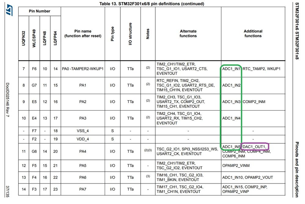

The data sheet breaks down those connected to an ADC, ie ADC123_IN4
The reason to turn ANY pin to analogue is to turn OFF the schmitt trigger on the input that feeds down stream digital logic and GPIOx->IDR, etc. This avoids noise, and potential oscillation.
Use the ADC to measure the supported pins, use the DAC to output to supported pins. Review the Data Sheet

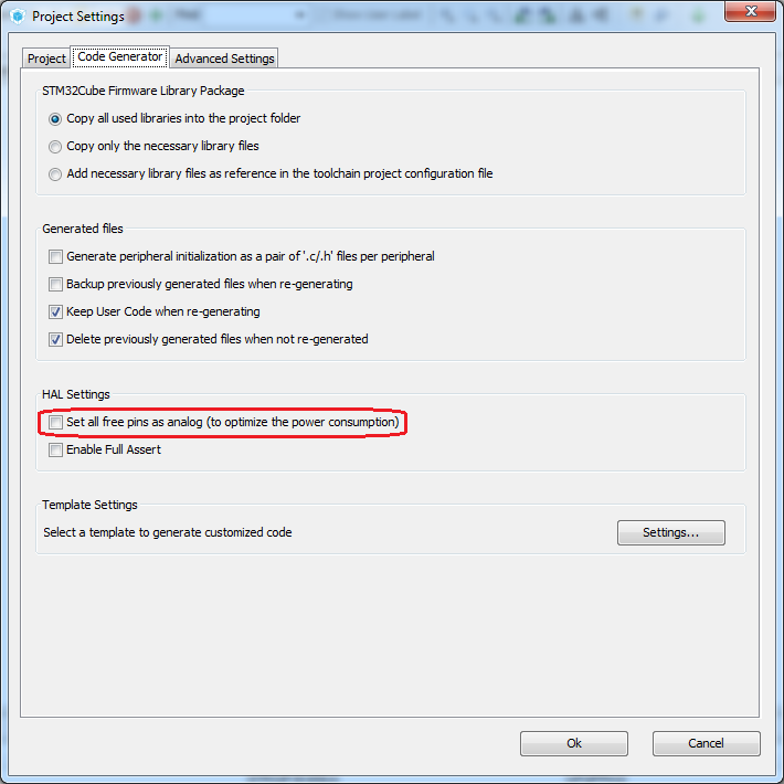

for this answer. On the top of what you said I would like to add that switching off GPIO's Schmitt trigger also decreases a bit current consumption of MCU. That is why Analog Input is a recommended mode for all GPIOs, which are unused by application.
Analog Input is a default mode of GPIOs inlow-power STM32 MCUs: STM32L0 and STM32L4. For other STM32 familiesuser has to take care about configuring unused GPIOs in Analog Input mode. This task can be easily done with STM32CubeMX:

Thank you for this info. Yeah I went over the datasheet before creating the PCB and this was not very clear to me. Do you mind mentioning which page you are referring to and possible a small explanation? The datasheet in regards to ADC and DAC is very confusing.
Posted on February 21, 2018 at 01:37
PA0 Channel1 of ADC1
PA1
Channel2 of ADC1
PA2
Channel3 of ADC1
PA3
Channel4 of ADC1
PA4 Channel5 of ADC1 or Channel 1 of DAC1
