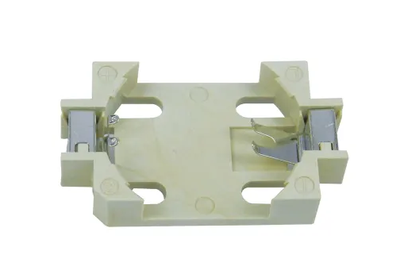

This is a non-existent problem. If you insert the cell incorrectly into a metal holder, it will be shorted.

just use a cheap standard batt. holder, inserting wrong direction - nothing happen, no contact on "-" .
problem away...

In one design we use a vertical holder because of spatial constraints, and the cell can very well be inserted reversed.
