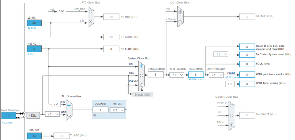

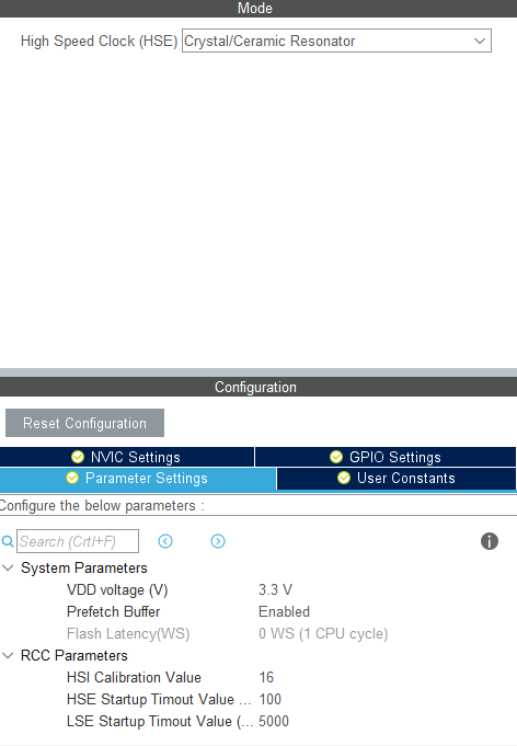

2019-10-17 9:49 AM
Maybe you should check from the generated code, that the clocks ate, indeed, set up the way the picture shows. Especially check the systick clock divisor selection bit.
I recall that bit defines whether the systick runs in the bus clock speed or if the clock is divided by 8. At least Atollic debugger shows the HW registers.
2019-10-18 2:21 AM
thank you now it works fine. i added these.
SysTick->CTRL &= ~SYSTICK_CLKSOURCE_HCLK_DIV8;
SysTick->CTRL |= SYSTICK_CLKSOURCE_HCLK;
