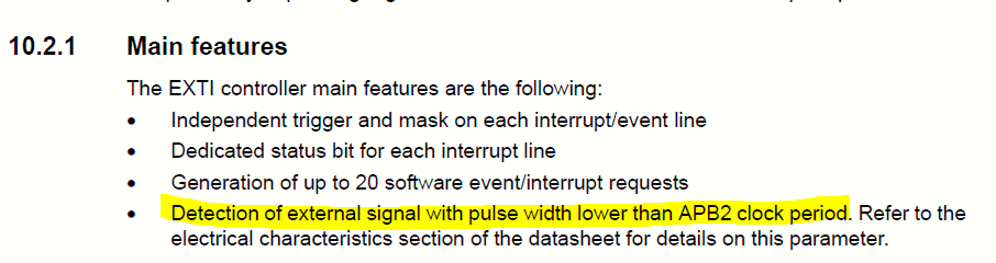

A minimum pulse width on EXTI is enough to trigger the interrupt. This minimum pulse width is not dependant an th APB2 clock frequency,
2017-12-29 9:28 AM
But is likely dependent on the resychronizer at the pin.
2017-12-29 3:15 PM
Clive,
this has been discussed a couple of months ago, and as Edison from the ST Prague support group confirmed, EXTI is surprisingly asynchronous.
Jan
