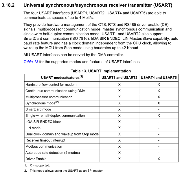

For IRDA, a HAL_IRDA group is available.Now aside from available HAL services, your device embedds several UART/USART instances. In corresponding datasheet (
) you should be able to find capabilities of each USART instance available on your L073. Some features are available only on some instances :For example, you could use USART1/2/3/4 instance for achieving UART transfers (using HAL_UART functions), USART1/2/3/4 instance for achieving USART transfers (using HAL_USART functions), but if you want to use HAL_IRDA functions, you will have to use either USART1 or USART2 instance in the device (USART3 and 4 not supporting Irda). Please extracted table below.
Hope this helps.
Regards
Guenael
