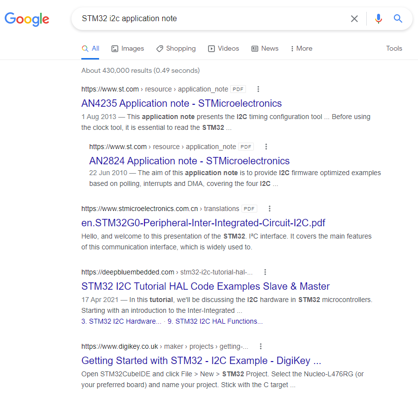

ST has Application Notes on how to properly use the I2C hardware - check on the Product Page for the particular chip(s) that you're using.
Also 3rd-party resources; eg,
