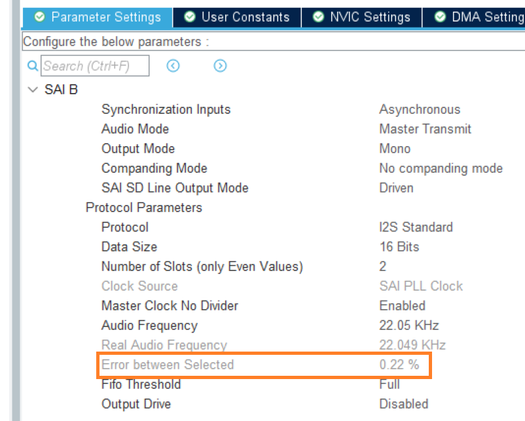

Today I spent some time to fine-tune SAI clock to get standard 22.05kHz sample output rate.

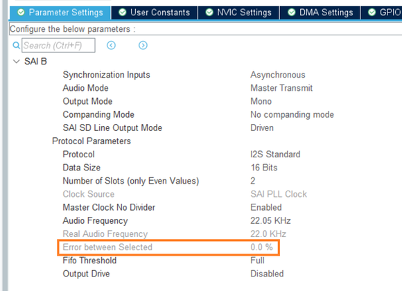

However, I do not understand why CubeMX states that "Error between selected" is 0.22%.
What is "Error between selected"? Why this error is zero when selected frequency actually differs from the desired value by 0.05kHz? Am I missing something?

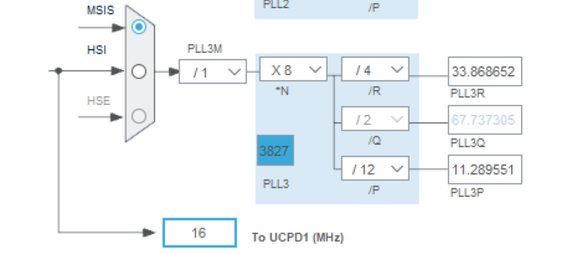

@AScha.3 I agree. Luckily, by fine-tuning PLL one can get really close and 0.001 HZ difference should no be audible even to musicians blessed with perfect pitch. That remains to be tested yet. Another approach I tried was using PLL 441x multiplier but I could not find settings within allowable frequency limits. So the current approach, that is, PLL3 clocked by 16MHz MSIS CRS-SYNCed with very stable LSE 32.768 kHz, may be the best one.
i (until now) never used the fractional setting in pll, because the jitter on the STM cpu is anyway not great, a cheap ESP8266 is better. And the fractional part...what could it do? switch the pll divider a step an back, in sigma/delta way. i cannot imagine, this will make a useful clock...did you check the jitter?

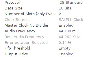

and for other dac, SAI in master transmit, i used:
with HSE 8M crystal , gives in Cube:
0,086% says my calculator. :)  (44100 / 44062 = 1,0008624) too difficult for STM software.

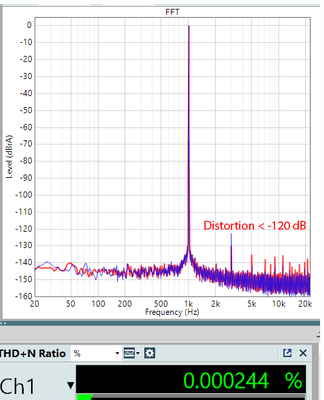

Concerning STM32 PLL and jitter:
I have used a few Nucleos (G4, F767, H723, with the ST-Link MCO as clock source) and a H735-DK and the PLL as source for SAI / I2S.
I have not seen any bad impact on signal quality, with TX-SPDIF and with 115dB SNR audio ADCs (sampling rate up to 200 kHz).

To be exact, it's the inverse: 44062 / 44100 - 1 = -0,0861678 %. ;)
I looked at the CubeMX calculated "error" numbers and realized what they are calculating. A warning - sit down so that you don't fall of your chair!
For 44,062 kHz: 62 / 44000 = 0,14 %
For 22,049 kHz: 49 / 22000 = 0,22 %
For 22,000 kHz: 0 / 22000 = 0 %
A pure kindergarten...
@TDJ , the 16 MHz / 4 * 127 / 45 gives a frequency, which deviates from your ideal target frequency by -63 ppm. Humans can detect a pitch variation of 0,3 % (3000 ppm) at best. And that is for a variation, not a constant offset! In other words - there is absolutely no point in using a fractional PLL mode and increasing the jitter unnecessarily.
